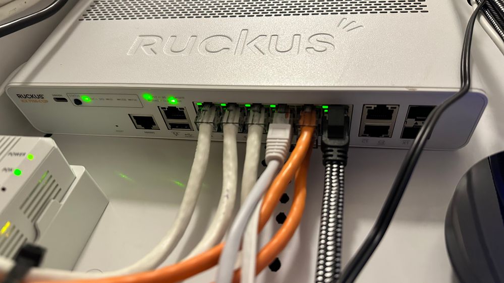

As per the pictures you shared, the Switch and the Access Points seem in a normal state.

Could you please help me with a FULL picture of your RUCKUS ICX-7150-C12P Switch showing all the cable connections as shown in the below screenshot?

Hi @rbuca1
Light status and cable connections seem normal.

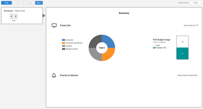

Could you please login to your Unleashed system on a web browser using the Master AP IP Address or https://unleashed.ruckuswireless.com/ and share the screenshot showing the below information?
Please help me with the above queries and let me know if you have any queries in this regard.
10-02-2023 05:52 PM
Yikes, I don't have a switch listed. How can I get this added?
