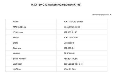

 I can supply this info from my admin console

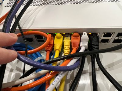

Here is a picture of the switch:
