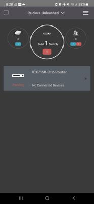

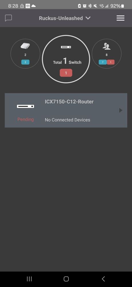

I was on vacation and came home to my unleashed app showing as a router instead of a switch.
I tried rebooting the switch by am seeing the following in the unleashed app.
Based on the screenshot is this the case?
If so how do I fix this? Is this something that is easy to do?
Thank you

As per the case description, I understand that your RUCKUS Switch in Unleashed is showing a Routing code.
This may be a Routing Code issue due to a power outage/spike. Please refer to and follow the below RUCKUS ‘Lennar Knowledge Base’ self-help guide to troubleshoot this issue.

Hello Imran,
I did the network scan and see the following listed:
icx7150-c12-router.
Does that mean my switch is showing as a router? When I used that IP in the url it took me a rucks screen with a login.
I aslo see a Ruckus Zoneflex listed

Hi @cmaldoff
Yes, the RUCKUS ICX-7150-C12P Switch is stuck on Routing Code. Please perform the commands in CLI mentioned in the guide to fix this issue. And Ignore Zoneflex.
