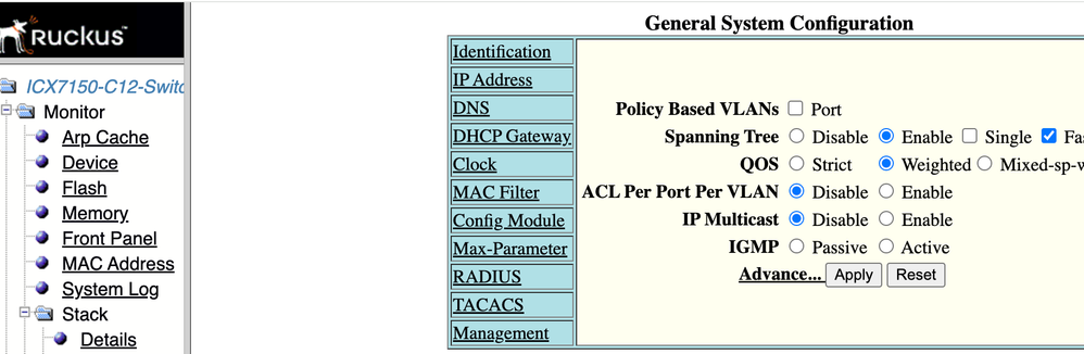

I was on vacation and came home to my unleashed app showing as a router instead of a switch.
I tried rebooting the switch by am seeing the following in the unleashed app.
Based on the screenshot is this the case?
If so how do I fix this? Is this something that is easy to do?

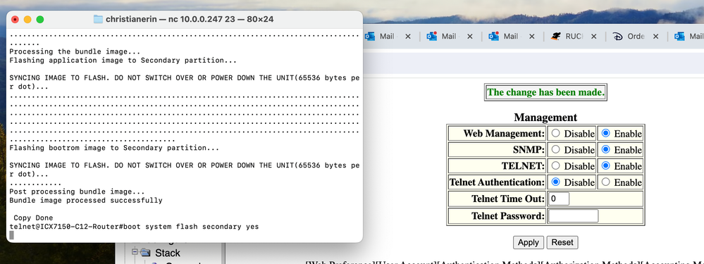

Please follow to the below screenshot and enable Telnet:
Once you enable Telnet try to access CLI from the MAC terminal as described below. And perform the commands mentioned below to get this issue fixed.
Example "open terminal":
Telnet: Example
nc 10.0.0.132 23 (Format is : nc <ip address of the switch> 23)
Please Enter the below commands in CLI to fix this issue:
copy flash flash secondary
Example:
VIDEO LINK AS REFERENCE: https://www.youtube.com/watch?v=Eem1IBgYaWc
ICX7150-24P Router#copy flash flash secondary (hit enter to accept the command and wait: until the flash finished)
ICX7150-24P Router#boot system flash secondary yes (hit enter to accept the command: the switch will reboot)
01-18-2024 11:17 AM
I was able to get in and follow the steps.
It is now stuck on after I ran teh boot system flash secondary command
Does this take awhile to complete?
