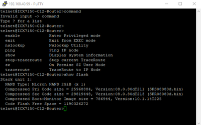

07-18-2023 10:52 AM
Ok I can get back in now. I posted screenshots previously. Do you still need more?
07-18-2023 10:53 AM
here is "Show flash" command
