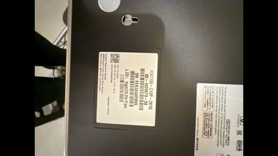

Hi, we have a Lennar home and Ruckus Switch. We have done a hard reset but cannot log onto the unleashed app or web browser to be able to update our switch and our AP extenders. We were never given a master or default password and I have tried every combination found on the forum. I am stumped. I took down the switch to see if the default password:login was on the back but it is not. It is not in any of our paperwork. The switch and the extenders 510’s show up on the Netgear Nighthawk app and I see the ip addresses but when I try to log in…I don’t have the credentials needed. I don’t believe that a password recovery was set up as the system was already set up when we moved in. HELP!

Hi Imran,
Thank you for inquiring on my progress. Unfortunately none of the user and password combinations worked. I cannot log into the switch or extenders with anything.
