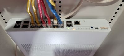

Hi @Janele84
As I can see from the picture you shared, there are lights on PWR and SYST, if there is an amber/orange light on the "SYST" and a green light on the "PWR" on the Switch (as it is in the below picture). Meaning the Switch is stuck in the boot mode.
Basically, due to the power outage/ power spike, the switch went to a state that we call ‘boot mode’ that is not able to boot up properly.
First, we will try to reset the Switch as described below:
IF RESET IS NOT WORKING, PLEASE TRY TO RESET YOUR SWITCH MULTIPLE TIMES (Like 10-15 times) AS DESCRIBED ABOVE.

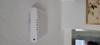

As per the case description, I could understand that your RUCKUS setup is not working, after a power outage.
2. Is your Internet Connection from the Internet Service Provider (ISP) stable and working? (You could check this by connecting to your local router Wi-Fi or from an ethernet cable from the Router to a laptop/PC).
3. May I know how many Access Points are connected to the Switch? Could you please let me know the light status on the Access Points? Any of these lights are on (Please refer to the below picture and share a picture of the same)
09-11-2023 12:50 PM
1. There is no light. It's absolutely dead.
2. internet from internet provider is stable.
3. No lights are on. Security cameras, garage door, laptop, TV are connected.

Could you please share a picture of the RUCKUS ICX-7150-C12P Switch as well?
Thank you again.
