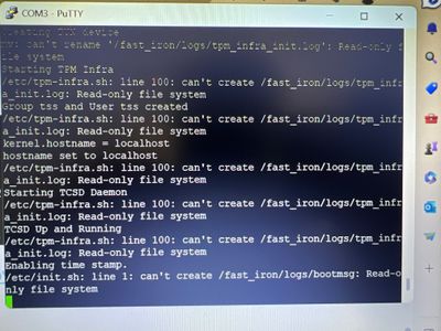

Hello,
My switch is not sending power to any of my equipment. The SYST light is orange and I have read through the forums and tried factory resetting with no luck. I am not to familiar with Putty and have also tried those steps looking through the forums. Is there any other way I can get help with this?

Hi @Ch823
As you have performed the software recovery to the Switch which is already of 08.0.90 or later. However, you could Upgrade your Switch to the latest version.
Could you please share a full screenshot showing the information?

Ch823
I was able to get everything to boot up and turn green. All the AP’s are on and green.

Hi @Ch823
Great!!! Good to know that you performed the Software recovery successfully and that the Switch and access Points are back to their normal state.
