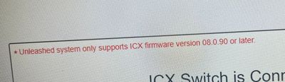

All AP’s upgraded to newest version. Can I update the ICX 7150 to a newer version through the internet or does it have to be done through Putty? I am getting the below message about the switch on the Ruckus screen. 80.0.90 was the one I did when I followed the previous steps. If it has to be done through putty what version do I need to use?
Hi @Ch823
As you have performed the software recovery to the Switch which is already of 08.0.90 or later. However, you could Upgrade your Switch to the latest version.
Could you please share a full screenshot showing the information?
