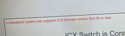

I am getting this error for the switch. Do I upgrade the same way it was brought back online? If so are the steps exactly the same and which versions should I upload to the switch?
thank you.

Hi @Ch823
Thank you for the response and for sharing the requested information.
As you mentioned, your Unleashed Access Points are on an version 200.9.10.4.212 which is a older one. This may be the reason you are unable to log into your Unleashed Application from your smartphone.
We suggest you upgrade your ALL RUCKUS R510 Access Points to version 200.14.6.1.203 which is recently released.
