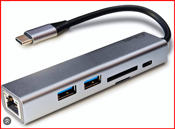

If your laptop does not have a built-in Ethernet port, we recommend using an external Ethernet adapter (please refer to the screenshot below for an example).
Once you have the adapter connected, please proceed with the steps and let me know how it goes.

As mentioned previously, if your laptop does not have a built-in Ethernet port, we recommend using an external Ethernet adapter (please refer to the screenshot below for an example)
