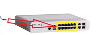

2:If the sticker was not found, wire the computer to the ICX 7150 Switch, causing the computer will be in the same subnet as the Access Points, use any of the yellow ports.
