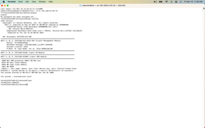

Hi @bindihar
Please follow to the below screenshot and enable Telnet then try accessing the CLI:
Once you enable Telnet try to access CLI from the MAC terminal as described below. And share the output of the commands mentioned below in this post.
If you have a MAC device, please try the below process.
Example "open terminal":
Telnet: Example
nc 10.0.0.132 23 (Format is : nc <ip address of the switch> 23)
If you can access the Command line using Telnet should look like below prompt:
????telnet@ICX7150-12P Switch>
show version
show flash

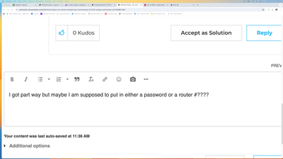

03-15-2024 11:36 AM
I got part way but maybe I am supposed to put in either a password or a router #????

03-15-2024 11:44 AM
Hi @bindihar
You have executed the command correctly. There is no need of adding anything.
As you know this issue is because your switch is running on the Routing code (SPR). The Switch should run on the Switching code (SPS) to avoid these issues for Lennar home users. Due to a power outage/power spike, the Switch boots up on the other partition which may be running on a ‘Routing Code’ results in causing this issue.
As I can see from the output you shared, your Switch is booted up on the secondary partition which is running on Routing code (SPR) as highlighted in the screenshot below.
Please Enter the below commands in CLI to fix this issue:
copy flash flash secondary
Example below:
VIDEO LINK AS REFERENCE: https://www.youtube.com/watch?v=Eem1IBgYaWc
????telnet@ICX7150-C12-Router>enable (hit enter to accept the command)
????telnet@ICX7150-C12-Routerr#copy flash flash secondary (hit enter to accept the command and wait: until the flash finished)
????telnet@ICX7150-C12-Router#boot system flash secondary yes (hit enter to accept the command: the switch will reboot)

03-15-2024 12:12 PM
Thanks so much Imran......that worked...got it switched to the right partition.
