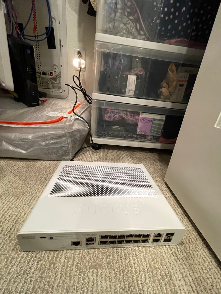

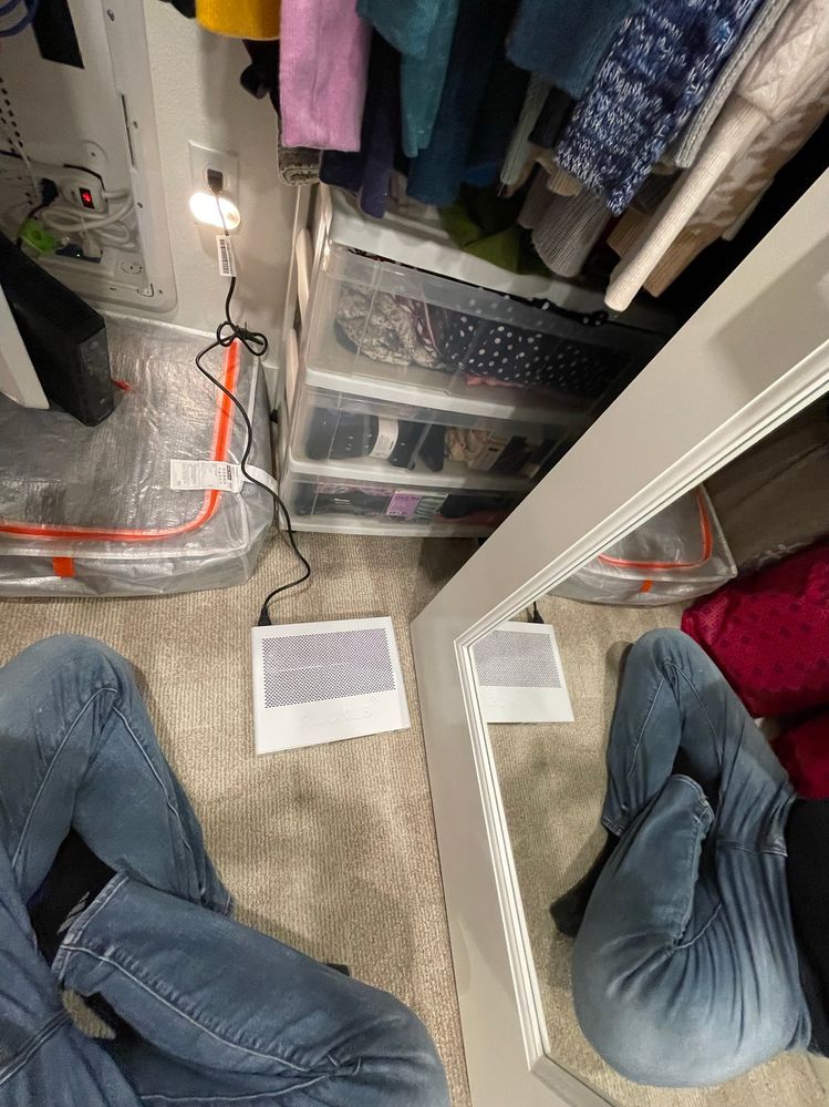

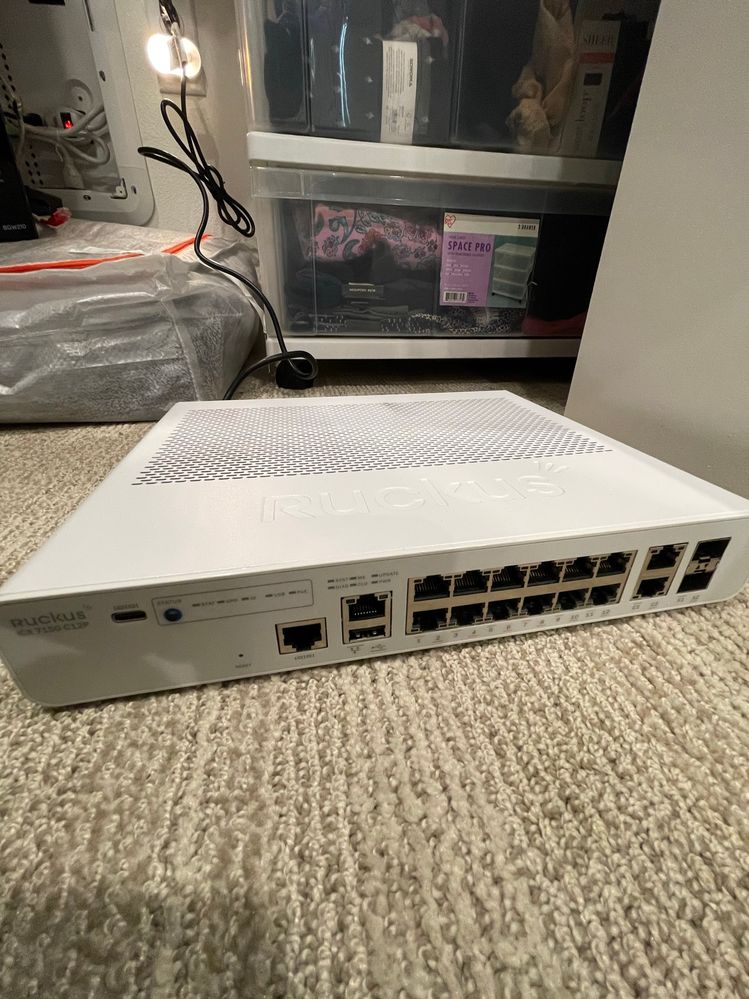

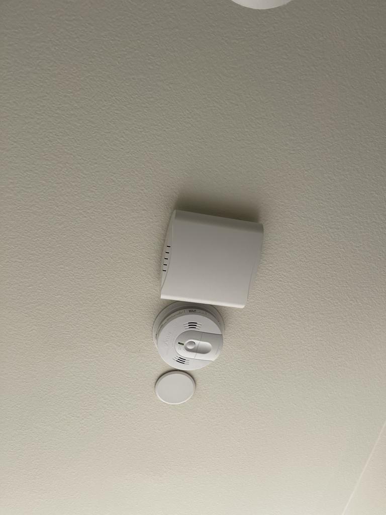

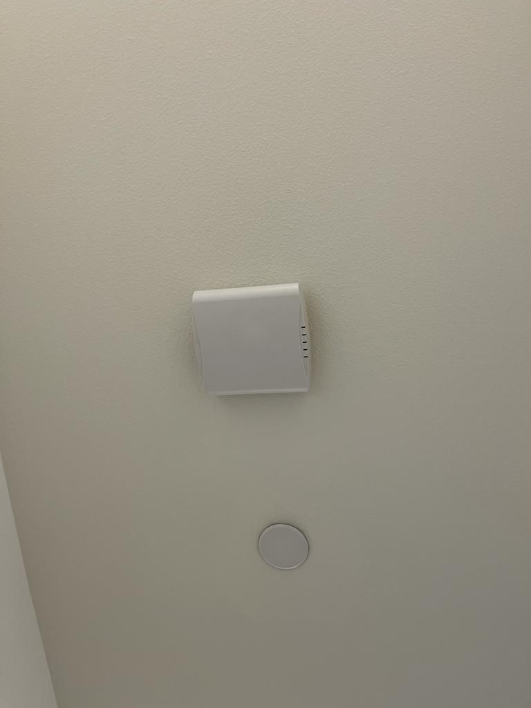

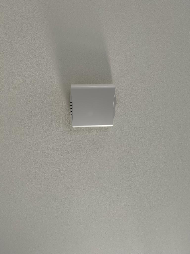

My ruckus system is not powering up , we do not have any lights in Ruckus ICX 7150 and in any APs. I have already tried multiple attempts to reboot whole system but nothings seems to be working. Please check below pictures for more details. Please help me fix this or guide me to right direction how i can resolve this.

If yes, could you please plug your ICX-7150-C12P Switch into a working power outlet and send us a PICTURE and VIDEO of it showing the light status, and cord connected to the Switch and working power outlet? Please refer to the below pictures as an example.
