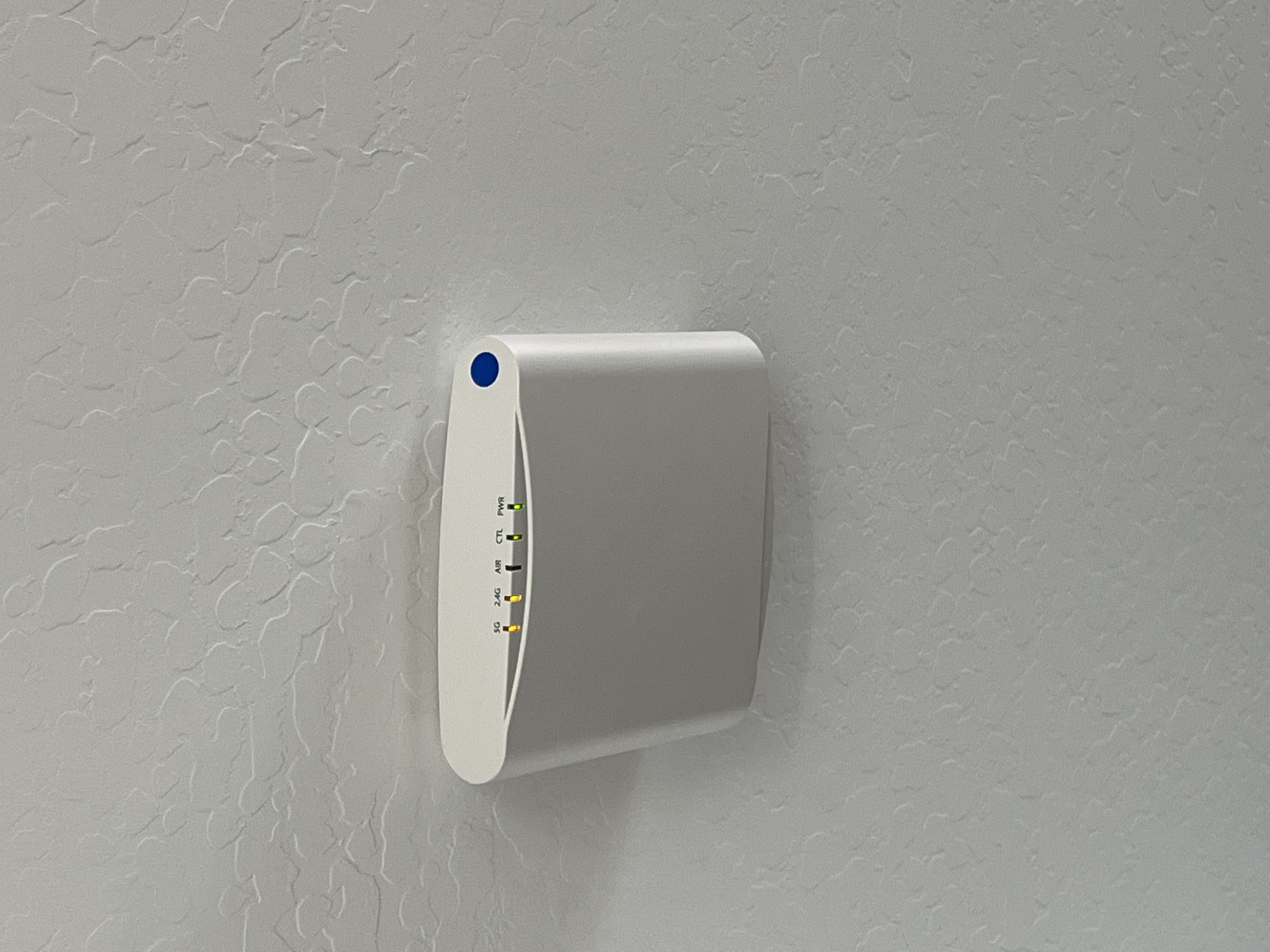

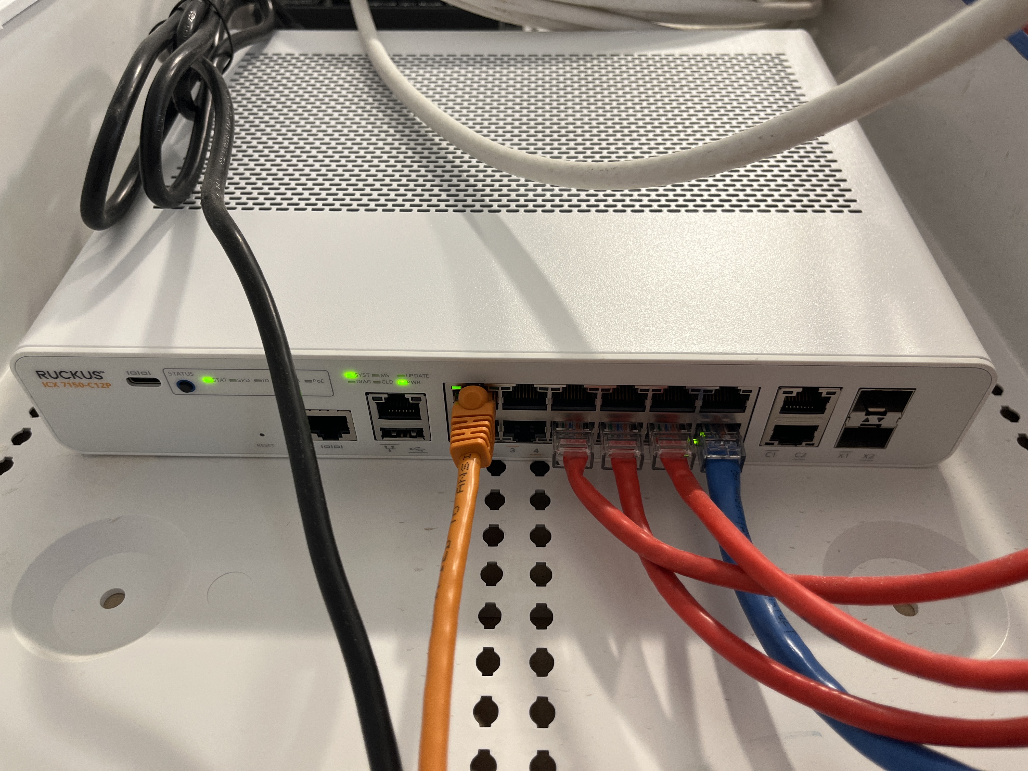

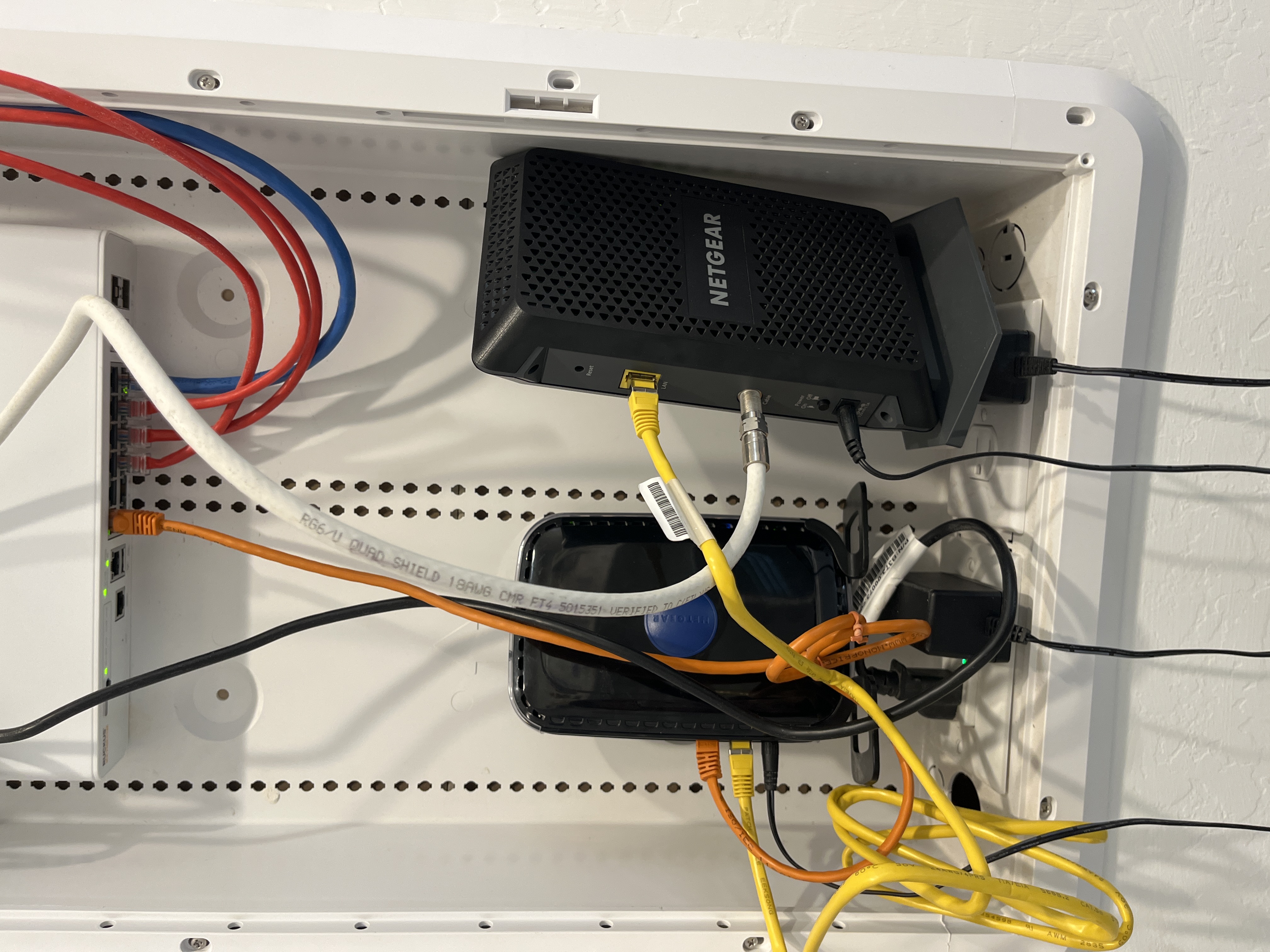

I have my modem and router connected to the switch ICX 7150. All lights are green. The AP is all green and amber lights. I used the setup process found on the inside of my electronic door panel. I see the AP WiFi as Lennar-XXXXXXXX. And I have the password. I can connect to the Lennar WiFi, but it’s so SLOW or doesn’t work at all even with all green lights or amber lights when I connect to the AP. I switch back to my router’s WiFi and it’s working fine. Any steps I can take to fix this?

Based on your description it seems like your switch (ICX 7150 switch) may be booting from the secondary partition (NOTE: Secondary partition contains the routing code) which is causing the bad connectivity issues. This could happen after multiple power outages, please follow up the next guide.
Guide#1 for CLI:
Guide#2 for CLI:
Note: if you have access to the Unleashed Dashboard and the Switch can be seen from there, it may look like the following image, ICX7150-C12-Router instead of ICX7150-C12-Switch, now before starting the steps of the guide, I will advise you to cable the computer directly to the Switch, since you will have a better connectivity than if you connect via wireless.
After fixing the issue of the Switch booting from the wrong partition, please perform an upgrade to the code 08095g UFI and upgrade both partitions primary and secondary with the switching code file named SPS08095gufi.bin, take into consideration that is the Switch is running a code lower than 08080 you need to upgrade twice, from the code you are to 08080f and then the recommended code 08095g UFI.
