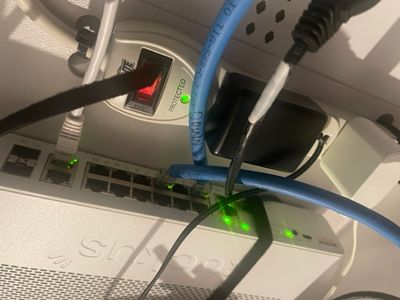

Hello Imran,Thanks for the quick response.1) I don't see any amber lights on the switch . All the lights that are on are green. Please see the attached picture of the switch light.2)Internet connection from ISP is very stable and good. I have no issues connecting to wifi thru the router.

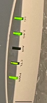

3)I have 2 access points for each floor. First floor has 4 green leds on.. the middle light which says "air is off. In the second floorthe I have 1 amber light on. LED light which says "5g" is amber. and "air" and "CT"L are turned off." I have attached pictures of the access points for both the floors.
Let me know if you have questions.
I have also attached the pics in the email.
Thanks
Rishi

As I see from the picture you shared, seems like the ethernet cable which is coming from the Router or Modem/Router combo is plugged into the wrong port on the Switch panel. It must be plugged into any 1 in-12 ports as shown in the below screenshot. Please unplug the ethernet cable and plug it into the correct port and I will share a factory reset process of the Access Points in a next post.
