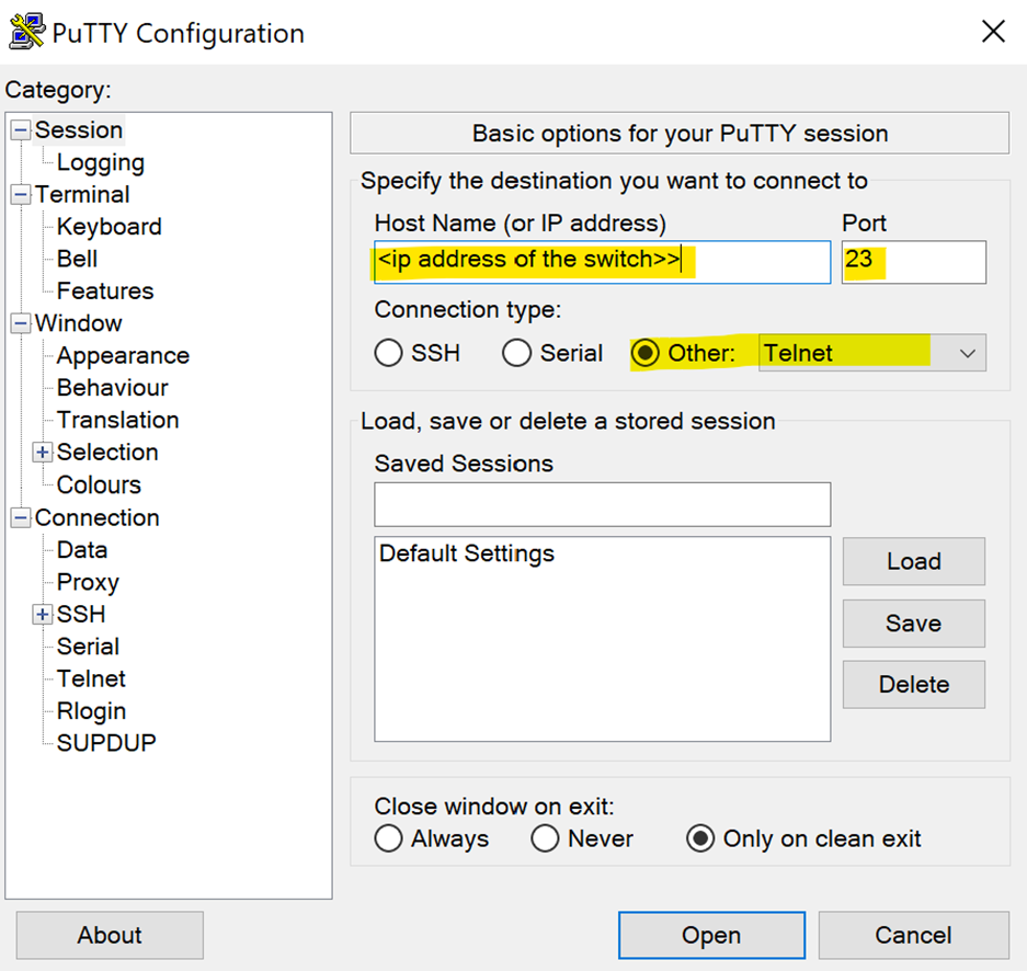

I am at a loss I have set it all up through PuTTY but it keeps giving me a Network Error and timing out.
Hi  @Caliendo
Could you please try to log into the PuTTY using telnet option? (Refer to the mentioned screenshot)
Telnet – Port 23 (If SSH doesn’t work)
If you can login using Telnet option, please share the requested Command outputs.
