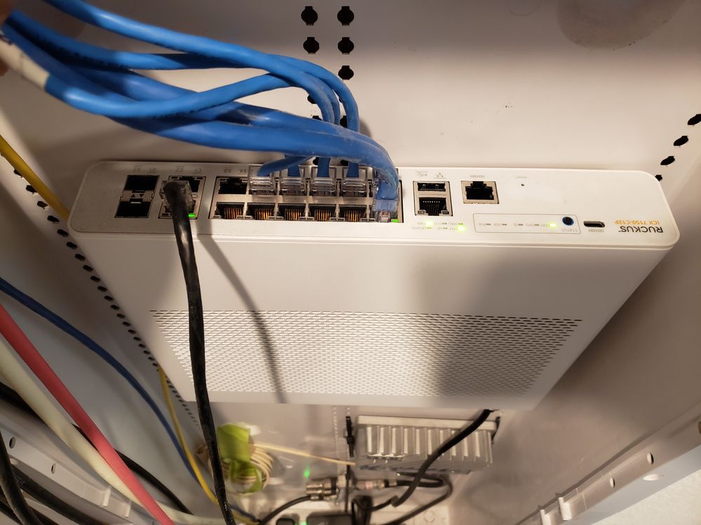

Last week I power cycled my ruckus unit and since then I have been having internet interruptions or extremely slow speeds. I had xfinity tech come over and they did not find any issues with the modem. I tried to follow other similar posts and tried to find the ruckus switch ip using the "LanScan" app on my Mac. I see 2 IPs listed as "Ruckus Wireless", but I believe those are the IPs for the APs and not the switch... the mac address for the IPs does not match the MAC address of the switch.

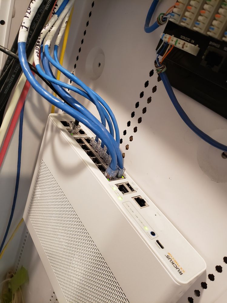

vsood1
New Contributor III
Hi @vsood1
As I see from the picture you shared, seems like the ethernet cable which is coming from the ISP’s (Internet Service Provider’s) Router or Modem/Router combo is plugged into the wrong port on the Switch panel. It must be plugged into any 1 in-12 ports for new versions, as shown in the below screenshot. Please unplug the ethernet cable and plug it into the correct port.
Once you plug the ethernet cable as per the above description, please try to access CLI using Telnet as described in one of my posts previously.
