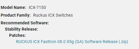

We have made 3 different ways to perform the upgrade to the switch via USB/TFTP/UI-TFTP , since you are already on 8090d code you can do the upgrade to the recommend version SPS8095g based on the support portal.
How to perform an Upgrade via Web GUI (ICX7150 Switch)

I downloaded the Software 08095g but in the ZIP there is no "boot" directory where I could find the file as described in the instruction?
