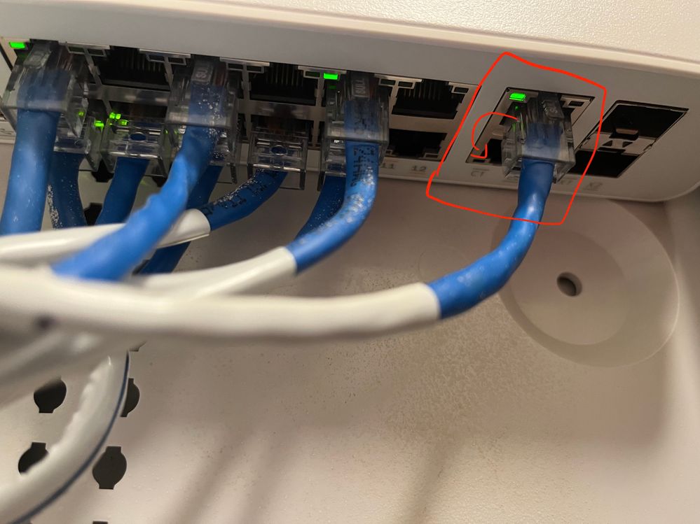

Just another note. I had performed factory reset couple of time before entering this help ticket. But I am still seeing intermittent internet dropout issues. I have to swap cable shown below many times in a day to get uninterrupted internet access.

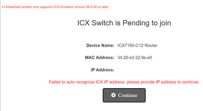

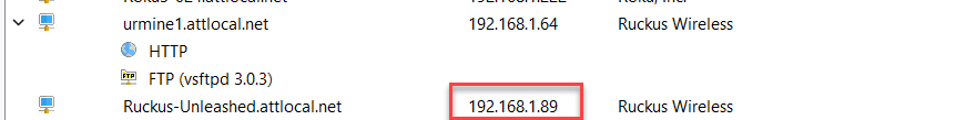

I am only seeing these two IP address. MAC address of these IP is not matches with ICX7150 device. So I don't know how to use steps that you have provided.
192.168.1.64 is same as unleased wireless access
192.168.1.89 is not working at all.
Any guidance or workaround in this case?
11-24-2022 11:15 AM
Automatically approve all join request from switch or identify IP address is not working..

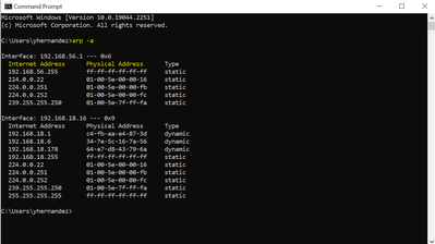

Perfect, but you know the MAC Address of the Switch, so will be matter to compare the MAC address with the IP address you will find if you run the Next command "arp -a" from your CMD(command prompt), let me add the steps, now if the IP was confirmed, and you cannot not gain access from Web the next step will be gaining access to the Switch via console and run the next set of command I will provide, which is also in the guide from console access.
1:MAC, the Address of the Switch to the IP address in the ARP table.

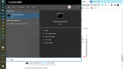

Start button>type CMD and open>run the command arp -a
Note: Now you know the IP address, try to gain access via web, and follow up the next guide:
