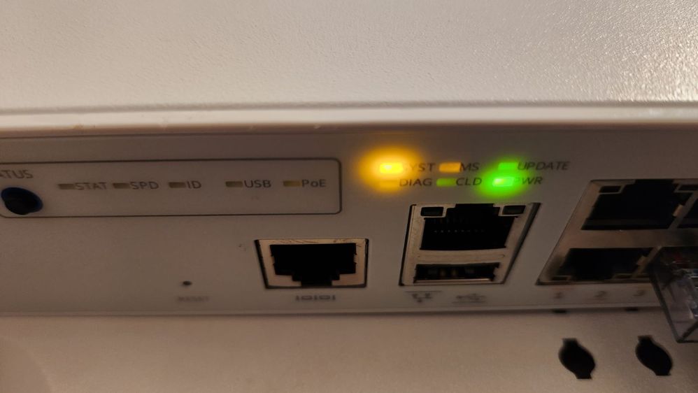

Thank you for your response. Please see responses below in bold and attached photos.
1. On your switch while it's plugged into the outlet, do you see any lights on? (Amber or green) Please let us know which lights are on.
SYST = Amber
PWR = Green

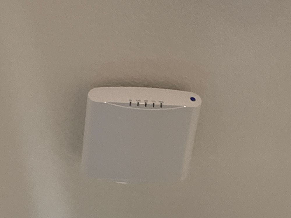

3. May I know how many Access Points are connected to the Switch? Could you please let me know the light status on the Access Points? Any of these lights are on

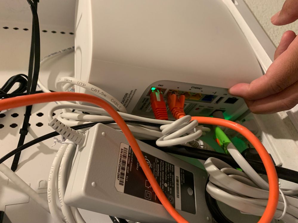

I could only find one and no lights are on; however, there are five total (4 blue and 1 grey) ethernet cables and I can't locate those APs. The orange one ethernet cable is attached from the Ruckus ICX to the ATT Fiber box. It's probably plugged into the incorrect slot on the Rucus ICX. Please see photos below.

Hi @Prairie
As you mentioned and I can see from the pictures you shared, there are lights on PWR and SYST, if there is an amber/orange light on the "SYST" and a green light on the "PWR" on the Switch (as it is in the below picture). Meaning the Switch is stuck in the boot mode.
Basically, due to the power outage/ power spike, the switch went to a state that we call ‘boot mode’ that is not able to boot up properly.
First, we will try to reset the Switch as described below:
  • Remove power from the switch.
  • Press and hold the Reset button while applying power to the switch.
  • After all the system LEDs flash amber, release the Reset button.
IF RESET IS NOT WORKING, PLEASE TRY TO RESET YOUR SWITCH MULTIPLE TIMES (Like 10-15 times) AS DESCRIBED ABOVE.

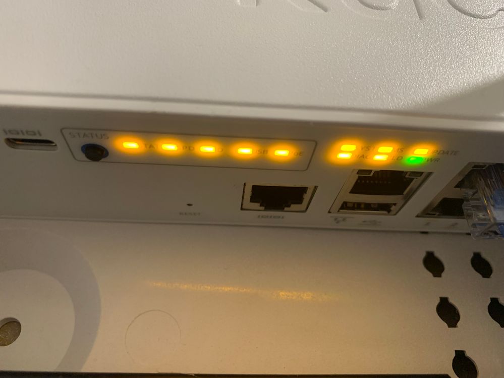

Prairie
This worked and all the amber lights are blinking as shown below. It has been blinking for about 1 hr now. I feel like there's progress, but what is the next step?
