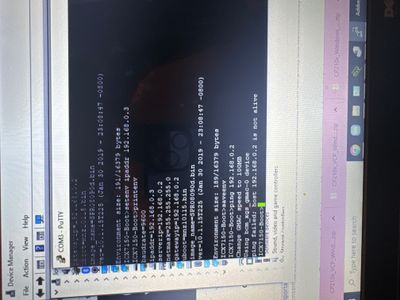

Could you please confirm if you see 'boot>' or 'switch#' prompt on CLI?
12-21-2023 06:00 AM
Reached the prompt screen
ping failed

Hi @faddymak
Please follow the below RUCKUS Lennar self help guide which will help you get this 'not alive' error resolved.

I don’t believe The files downloaded are correct
