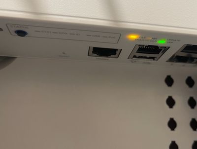

Hello, the switch has a green light for PWR and a orange light for SYST. Rest of the lights are off.
The Access points are all offline - no lights are on.

Hi @abhishekgirish
Based on your description, your switch has one green and one yellow light, which means that the switch is stuck in boot mode.
To solve this issue please try to do the hard reset of the switch by following the below steps.
10-30-2023 07:20 AM
Still the same issue Jaya. I tried hard reset. I had to travel, so couldn't follow up. This is new construction and a few neighbours had similar issues - and needed to replace the Switch for resolving it.
