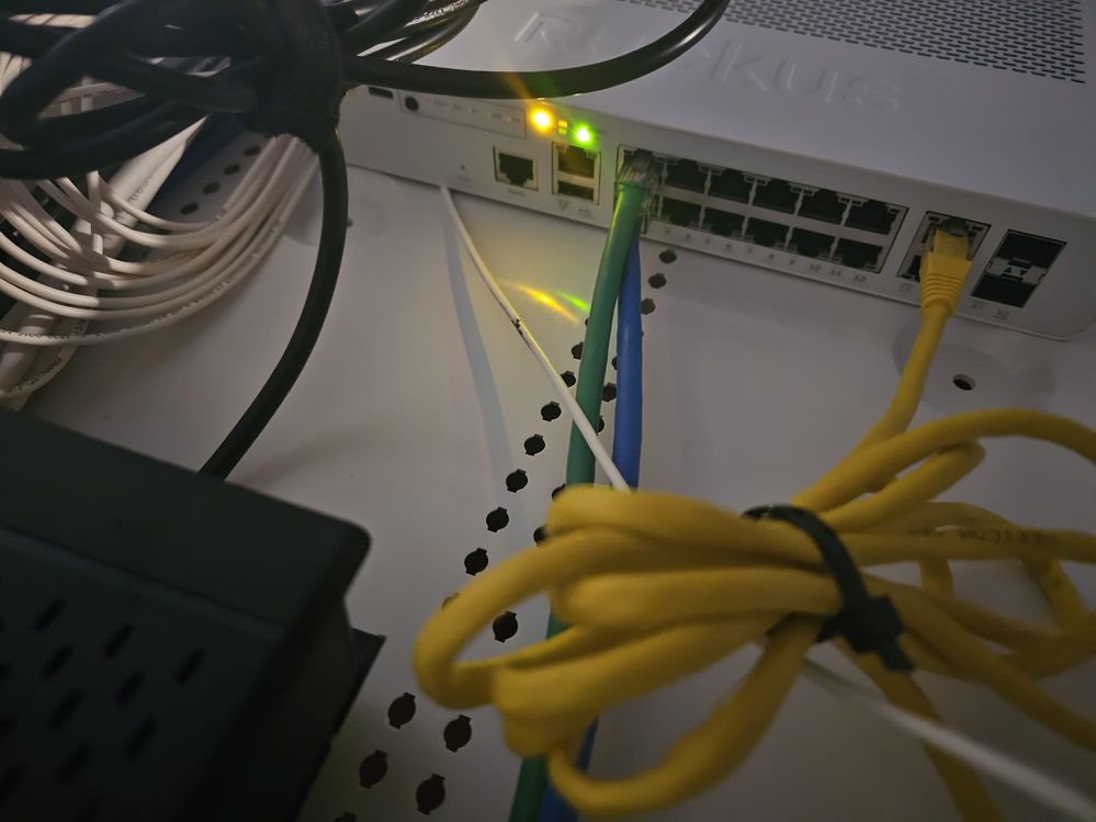

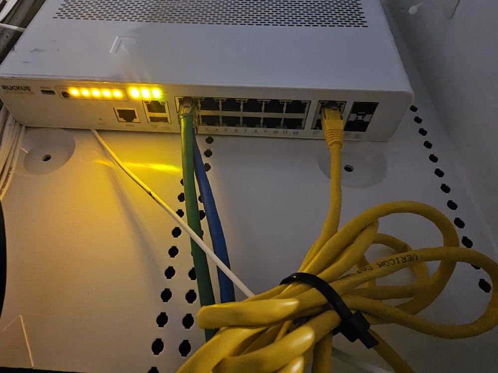

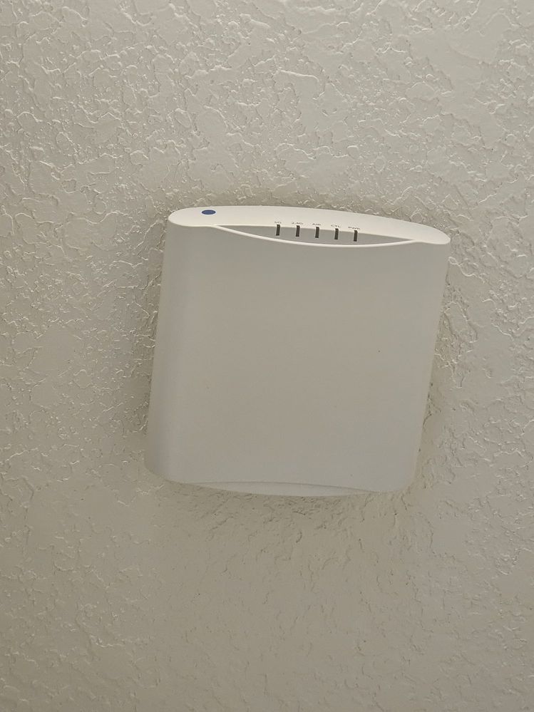

I was trying to arrange the wires and after everything was done I plugged everything in its place. When I did that one green and one orange light were steady and there was no wifi signal. I looked into few posts and tried to reset, now all the lights are blinking orange with one steady green. Please help.

For better understanding of the issue we request you to share the image of the switch and the access points showing the LED status and the cable connections.
AfterTryingToResetItStaysBlinkingForHoursAndHoursUntilISwitchOff (1).jpegImage.jpegAP.jpegBeforeReset.jpeg

Based on the images you have shared it seems like your switch has green and amber lights on it which means that the switch is stuck in boot mode.
As you have already tried the factory resetting the switch and the switch is not responding to the factory reset, you need to perform the software recovery process,
Please read the guide carefully before start the steps.
Ruckus ICX Recovery tutorial video
Note: after fixing the issue of the Switch been stuck in boot mode, please perform an upgrade to the code 08095g UFI and upgrade both partitions with the switching code file named SPS08095gufi.bin, so perform the software recovery using the code 08090k with the upgrade image file named SPS08090k.bin, then when the switch is back to normal upgrade to the file SPS08095gufi.bin for both partitions primary and secondary.

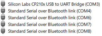

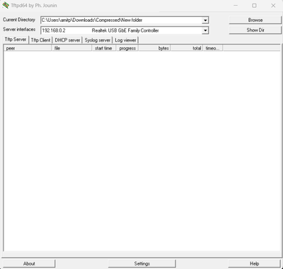

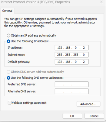

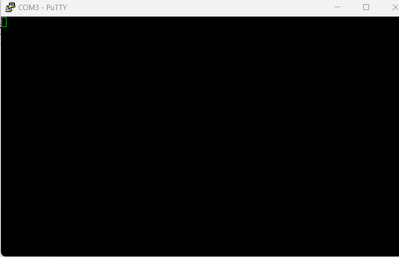

I tried the steps but I am not getting the terminal for the switch. Please Help
