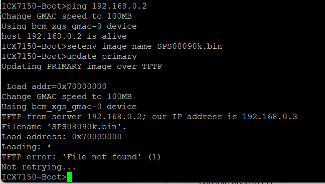

Our home lost power after which, our ICX7150 will no longer boot. The power light is green and the system light is steady amber. I've attempted a reset after which all status lights blink amber while power light is steady green. I have also tried to perform a software recovery following these instructions: https://community.ruckuswireless.com/t5/RUCKUS-Support-for-Lennar-Homes/How-to-perform-a-Software-re...
I'm stuck at the point where I test the connection via ping. The switch is not able to connect and gives an "is not alive" message when I ping the server IP. I get the same messaging when I attempt to ping the local IP on the switch as well. I've tried with multiple machines, network interfaces and cables with exactly the same results. Are there any other tricks I can try?

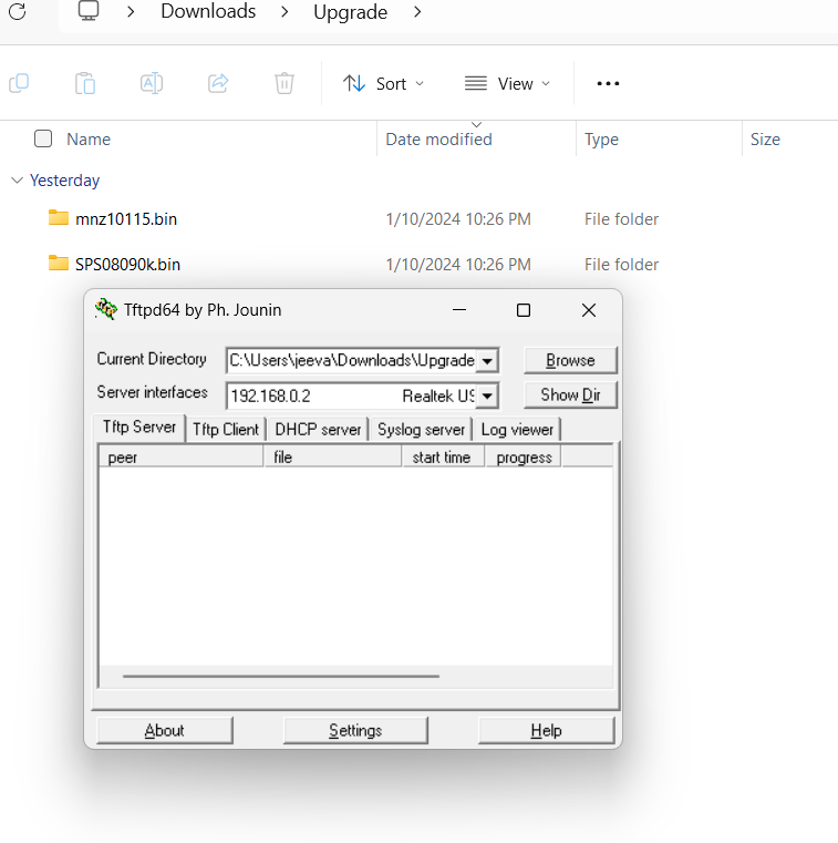

I was able to go past PING issue by removing firewall. Now I am having issues with TFTP - file not found. Could you please help?

The issue is resolved. I needed to copy just the two files to upgrade folder.
