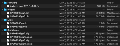

I am following this guide: https://community.ruckuswireless.com/t5/RUCKUS-Support-for-Lennar-Homes/How-to-Upgrade-a-Switch-ICX-...
However, the zip file (folder ICX7150) does not contain a boot folder as described in step 8.
Here is the folder structure of the zip file folder ICX7150.
Can you please point me to the boot file? Thank you.
Hi @On-the-green
Please note boot image will be available on in 8080f zip file.
