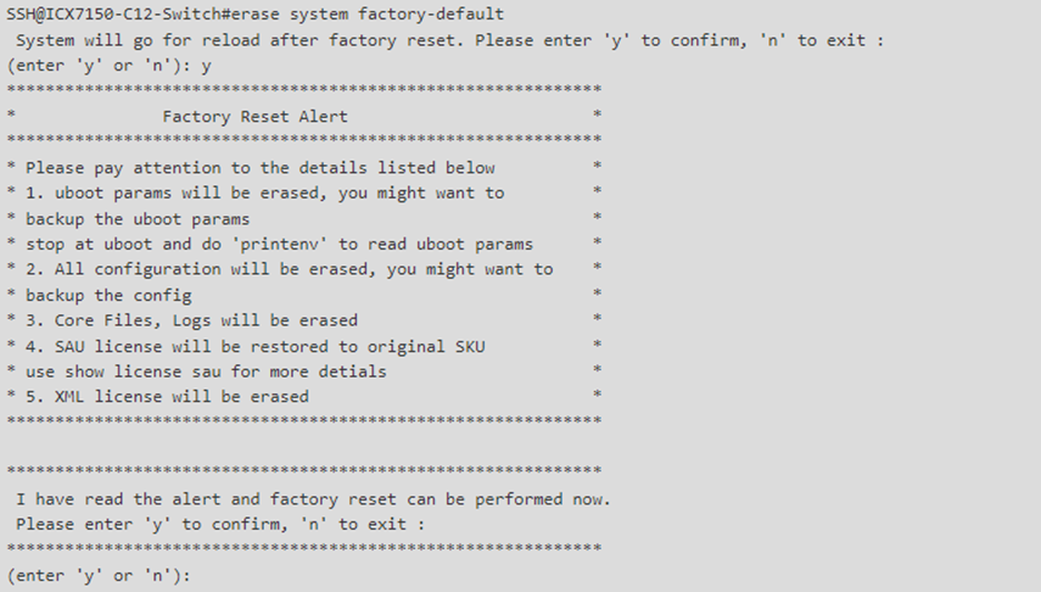

2. Additionally, please proceed with a factory default reset of the RUCKUS ICX-7150-C12P switch using the commands outlined below (also refer to the screenshot provided).
erase system factory-default
y
3. Have you tried performing a physical factory reset on the switch? If not, please refer to the RUCKUS Lennar Knowledge Base self-help article below for detailed instructions:
Please let me know how it goes once completed.
