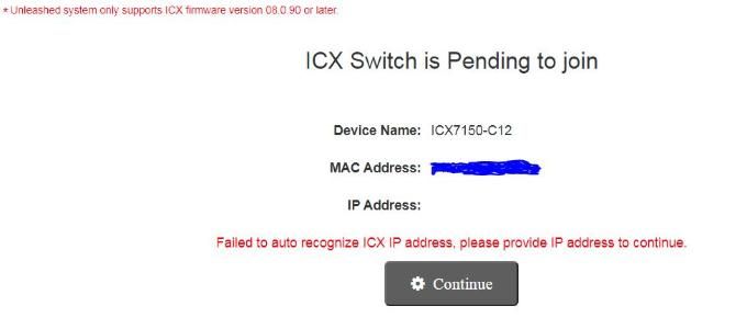

I can't enter the ICX CLI through Putty without the ip address (not assigned to ICX see below image). I know this is probably a very simple task, but how do I assign an ip address to ICX CLI without entering the CLI?
08-06-2021 06:04 AM
Error shows ICX is not yet joined controller.
You have to use console access and login into the ICX first and then assign the IP address.
Once that is done, approve the AP on Unleashed and you can manage it from Unleashed.
