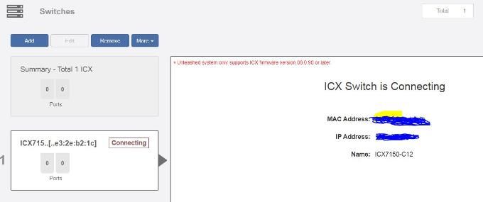

Like everyone else here I have a Lennar-provided ICX 7150 and two APs. Something happened over the weekend and the ICX started showing up as Disconnected in the Unleashed GUI. Symptomatically things were 'connected', but traffic through the ICX to our ISP's stupid combo modem/router was having lots of issues.
I searched around on these forums (before finding the Lennar-specific section) and found some people with similar problems getting an ICX to connect to Unleashed. I tried factory resetting the ICX and re-adding it, but that didn't work. The ICX shows up in Unleashed as Pending, then prompts to enter the IP to join it (Auto Approve is enabled but seems like the ICX is in 'Router' mode per the docs?).
No matter what I have tried, after approving the ICX, it tries connecting and then shows up as Disconnected with a message that the ICX could not be pinged.

Hi Jacob,
In a recent case, it was turned out the Ruckus switch booted into router mode. Customer had a brief power outage.
We booted it into switch mode and everything got stable! We also replaced the router image file with the switch image file so it won't go into the router mode in the future.
Check if if you hitting the same issue.

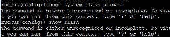

New to this.
Where are you suppose to enter those commands? I'm using putty and not getting any response back from the terminal.

I'm having the same issue as @omprakash_thamsetty where I can't connect to the switch. I just keeps connecting. If anyone can give me some instructions, would be greatly appreciated.
Image_ images_messages_610b45e7e0dc091733009e6a_4a6f66f780b8270037f6d974fe57a290_2-096951f9-7158-4777-a4eb-76bb3a365a2c-47620101.JPG
Hi @thomas_tseng @we can’t get the terminal when it say disconnected or connected . I did couple times a reboot then switch showed me connected. Once the switch connected then i used putty to run those commands . Actually support person ran the commands for me
Thanks for the quick reply. I did several (like 5 times) hard reboots already by disconnecting and reconnecting the modem and switch, but to no avail. Not sure if you're doing something different. Did you have to open a ticket and chat with them directly?
It doesn't look like you're SSH'd into the switch, did you go into one of the APs instead?
@thomas_tseng @I did like you. Hard reboot . Disconnecting power to modem and switch then connected modem and waited to come online and then connected switch . I did even more than 5 times . I frustrated doing that . I called support number to open a ticket
