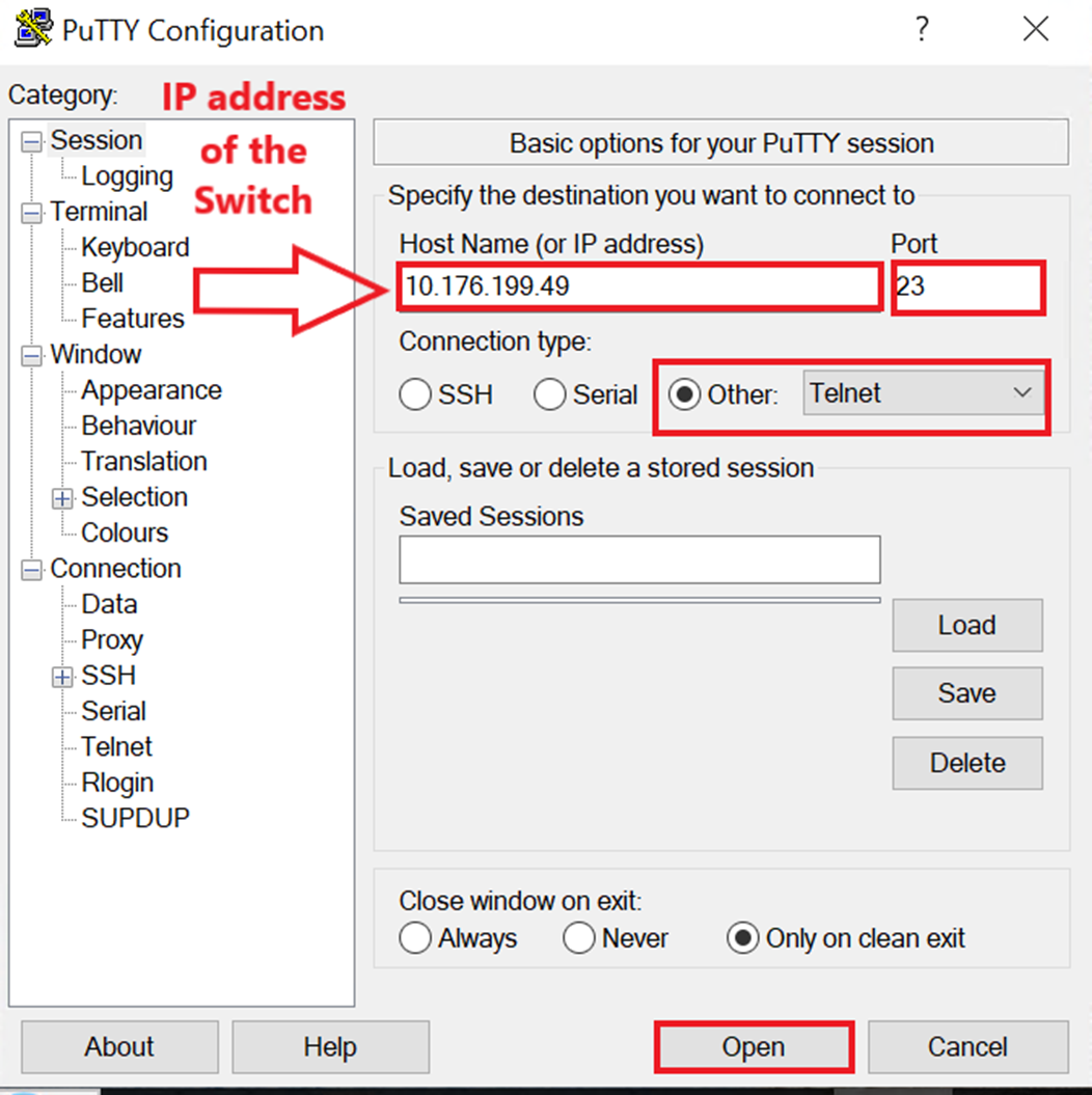

From the response shared, I understand that you are unable to access the CLI of the Switch .
Also, you have tried all of the default password combinations; however, it didn’t work.
I would request you to please login to CLI of the Switch using the Telnet option.
We do not need any login credentials to access CLI using the Telnet option.
Accessing CLI using the Telnet option
ICX7150-C12 Router> OR
ICX7150-C12 Switch>
Please follow the process and let me know if you are able to access  the CLI of the Switch.
