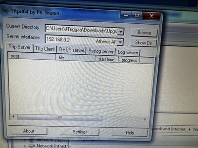

Apologies, as I see from the screenshot you shared, your RUCKUS Switch isn’t getting upgraded as per the process. You have used Switch IP Address in place of TFTP IP Address (Please refer to the below screenshot). Please use the TFTP IP Address in the command. (command- ‘copy tftp flash <tftp ip address> SPS08095gufi.bin primary').
It should look like as shown in the below screenshot.
Please follow the below steps as shown in the screenshot.
1. Browse and select the Upgrade folder containing .bin file. (192.168.0.2 is the TFTP IP address in the below example, please use your TFTP IP address in same place)
2. Click on ‘Show Dir’>>select 1st file>>hit copy
3. Open the CLI/Telnet and type the below command and copy the SPS08095gufi.bin file by right click on the mouse. (Ex: copy tftp flash <ip address> <right click> primary) Press Enter and now your tftp image will start copying.
