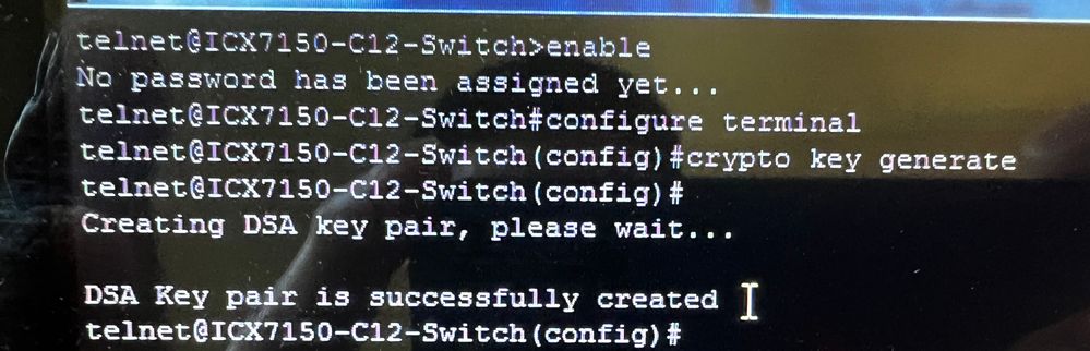

Im stuck at this after crypto key generate - shows successfully created..  how do i do these next steps.  How to confirm show ip ssh config
Please follow to the above process and confirm if the SSH status is enabled from the ‘show ip ssh config’ command. Once it is confirmed, please check the Switch status on the Unleashed dashboard.

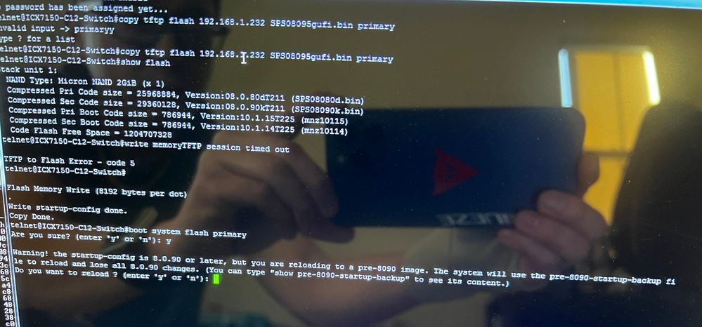

Im stuck with this final question..  I have downloaded SPS08095gufi.bin to update. but stuck... please advise.  see image.
now putty just kick me out... do i have go do this again>>  wahat is the answer to the ?  Y or NIMG_1669.jpg
Hi @jedy52
Apologies, as I see from the screenshot you shared, your RUCKUS Switch isn’t getting upgraded as per the process. You have used Switch IP Address in place of TFTP IP Address (Please refer to the below screenshot). Please use the TFTP IP Address in the command. (command- ‘copy tftp flash <tftp ip address> SPS08095gufi.bin primary').
It should look like as shown in the below screenshot.
Please follow the below steps as shown in the screenshot.
1. Browse and select the Upgrade folder containing .bin file. (192.168.0.2 is the TFTP IP address in the below example, please use your TFTP IP address in same place)
2. Click on ‘Show Dir’>>select 1st file>>hit copy
3. Open the CLI/Telnet and type the below command and copy the SPS08095gufi.bin file by right click on the mouse. (Ex: copy tftp flash <ip address> <right click> primary) Press Enter and now your tftp image will start copying.
