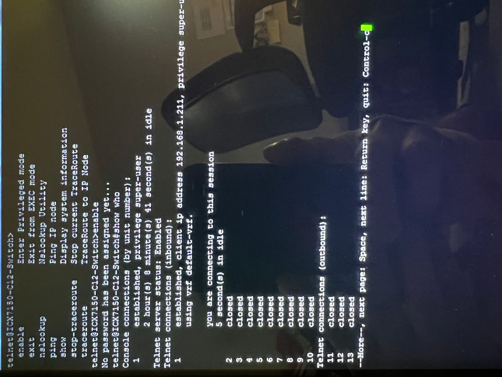

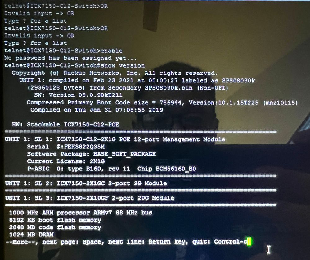

Imran,
Is this correct.. wasnt able to get through SSH but Telnet
are the commands correct?
10-12-2023 10:17 AM
Hi @jedy52
Yes, this is the information we require.
I see your RUCKUS Switch is on the correct SPS code as you have performed software recovery to the Switch recently.
To check this further, could you please the output of the below command as well?
show who
Please share the output of the above commands and let me know if you have any queries in this regard.
10-12-2023 10:28 AM
10-12-2023 10:56 AM
Hi @jedy52
I see the SSH access on your Switch is in a disabled state (please refer to the below screenshot), is the reason your RUCKUS ICX-7150-C12P Switch is not getting connected in the Unleashed system.
Please execute the below commands in the CLI which enabled SSH, and your Switch should get connected in the Unleashed system.
telnet@ICX7150-C12-Switch>enable
telnet@ICX7150-C12-Switch#configure terminal
telnet@ICX7150-24P Switch(config)#crypto key generate
Please follow to the above process and confirm if the SSH status is enabled from the ‘show ip ssh config’ command. Once it is confirmed, please check the Switch status on the Unleashed dashboard.
As I see your Switch is on a Non-UFI version (highlighted in the below screenshot). We suggest upgrading your switch to the latest UFI stable version to avoid this issue in the future. Please let us know once you complete the above process to assist you with the Upgrade of the Switch.
