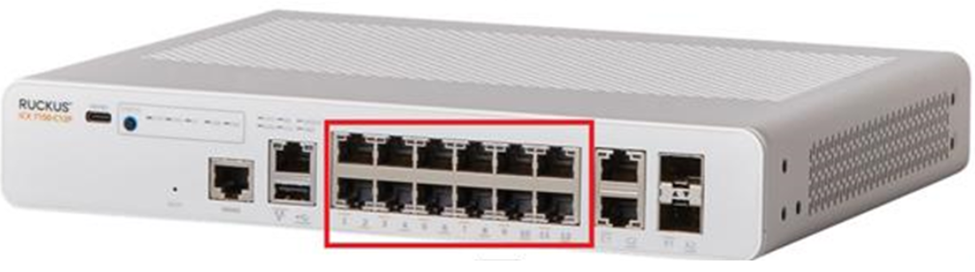

Hello @09stanggt ,
I would request you to please unplug the cable mentioned in the previous post and connect to one of the 12 ports and unplug and plug back the AP ports as well.
It should be plugged into one of the 12 ports as shown in the below screenshot.
Thank you for your patience.
