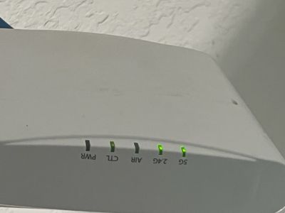

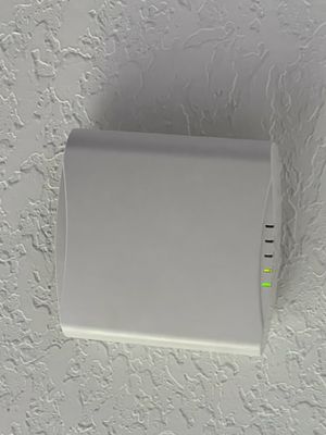

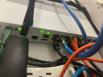

Hi @akalala
Please refer to the below picture and share a present picture of the same, showing the light status and the FULL Switch panel cable connections to the Switch ports.
07-07-2023 09:05 AM
all lights are green
