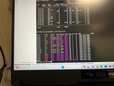

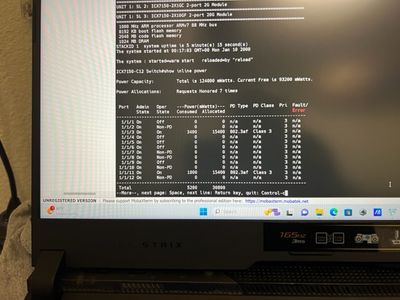

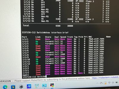

We lost power both APs aren’t receiving power after power returned. I have Reset all items several times APs and switch. I have switched cables where possible. I have attempted reboot using coms port that didn’t accept a boot load, flash attempted but failed. Boot said invalid. Not sure what I could do here.

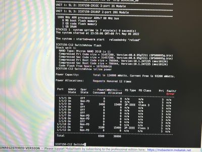

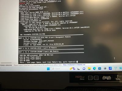

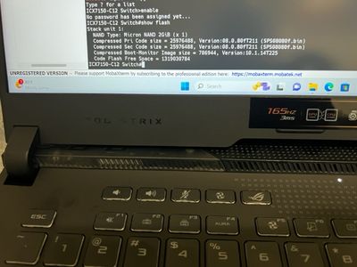

here are the updated images

I grabbed sps0808fufi.bin I couldn’t find the sps08080hufi.bin

Hi @akalala
As I can see from the Screenshots you shared, your Switch is now upgraded to the SPS08080f.bin Version.
Now please get the file SPS08095gufi.bin in place 08095hufi.bin (mentioned in the guide) file downloading it from the portal (Please refer to the below screenshot).
Below are the completed and pending steps:
mnz10114.bin bootrom – Completed
SPS08080f.bin – Completed
SPS08095gufi.bin – Pending
Please follow the below commands as mentioned in the guide as well:
“copy tftp flash <tftp ip address> SPS08095gufi.bin primary” - (upgrade the image)
“Show flash” - (check the primary flash has the new code)
“Write memory” - (save the changes)
“boot system flash primary” - (boot the Switch with the new code)
After the Switch comes back, run the next final command to copy what is in the primary partition to the secondary because we need that both partitions match.
"copy flash flash secondary" - (will copy what is in the primary)

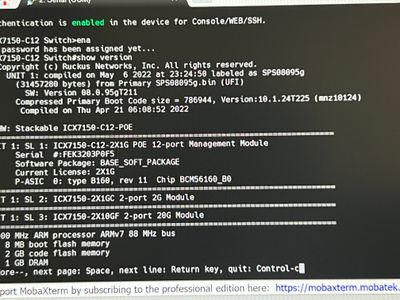

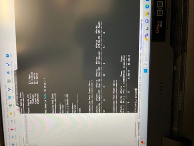

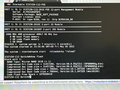

07-06-2023 08:05 PM - edited 07-06-2023 08:07 PM
adding pic

Am I able to reset my Ssid password now ?
