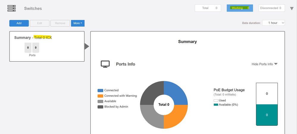

Hi @Therealx24
Thank you for the response and update.
May be your Switch is trying to sync with Unleashed system as CLD is light is blinking (Please refer to the below screenshot and the link.
Please follow the below steps to get Switch in sync with Unleashed. We will Add it to the Unleashed.
Steps to synchronize the Switch (ICX-7150-C12P) to the unleashed Access Points:
Switch side:
Make sure the management approval is enabled.
Access Points (unleashed) :
On the Unleashed dashboard
1- Remove the existing Switch from the Unleashed (Please refer to the below picture):
2-Hit Add on that dashboard
3-Put the IP address of the ICX switch (ICX-7150-C12P) and Password– If you don’t know the IP Address of the Switch. Please perform the below command from the Switch CLI to get the same.
Device>enable
Device#show ip address
4-Username and password for Switch authentication are the same as what you use to log in for Switch on Web or CLI (Putty).
To sync the data, it will take sometime, and it should say connected.
Once the Switch gets synchronized, please check the dashboard again.

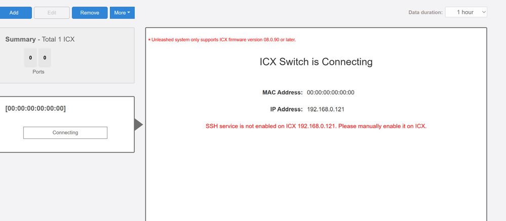

07-21-2023 01:08 PM
I'm seeing an error: SSH service is not enabled on ICX 192.168.0.121. Please manually enable it on ICX.
