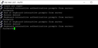

Hello. I've spent HOURS on these boards and honestly I feel computer illiterate after. I've downloaded Putty, found my IP address but can't get past the password thing in Putty. A power outtage made us lose quality access to Ruckus. Never really spent time on the app or website to know what it is for. PLEASE HELP!

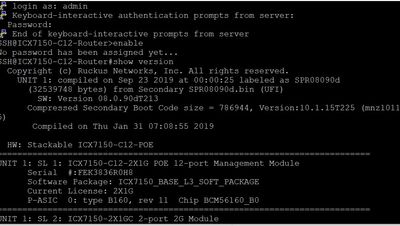

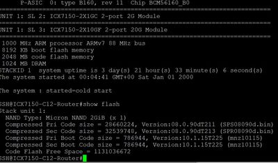

This issue is because your switch is running on the Routing code (SPR). The Switch should run on the Switching code (SPS) to avoid these issues for Lennar home users. Due to a power outage/power spike, the Switch boots up on the other partition which may be running on a ‘Routing Code’ results in causing this issue.
As I can see from the output you shared, your Switch is booted up on the secondary partition which is running on Routing code (SPR) as highlighted in the below screenshot.
Please Enter the below commands in CLI to fix this issue:
copy flash flash secondary
Example:
VIDEO LINK AS REFERENCE: https://www.youtube.com/watch?v=Eem1IBgYaWc
ICX7150-24P Router#copy flash flash secondary (hit enter to accept the command and wait: until the flash finished)
ICX7150-24P Router#boot system flash secondary yes (hit enter to accept the command: the switch will reboot)

I finally got into Putty. Now what
Example:
