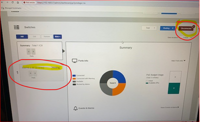

I was able to connect to the console with the console cable and revert the flash version back to SPS. That seems to have resolved the switch/internet issue. However, I was expecting to see the pending switch disappear in the Unleashed console, but it's still there. It's showing pending/disconnected. Is there anything I need to do to resolve that?
09-05-2024 08:40 AM
Hi @ksteph3
Could you please click on the Switch and provide a screenshot? For reference, I have included a sample screenshot below.
If you have any questions or need further clarification, please let me know.
09-05-2024 08:56 AM
That is my screenshot. That's the one I uploaded.
