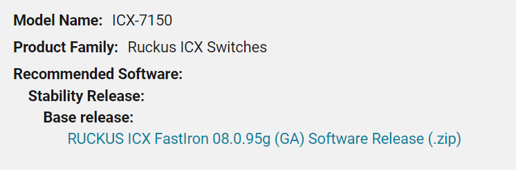

I used SPS08090k.bin per guide, but this seems old, which version do you recommend for upgrade? Or is it safe to keep the current version?

You can upgrade  the Switch to the base version '8095g' that is the recommend from the website.base.PNG
