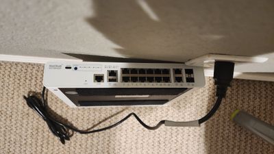

My ICX 7150-C12P does not power on anymore after a power outage. Lights do not turn on and I suspect the PSU is totally dead. Tried several working outlets and different power cords. Tried the "reset" button tip while plugging in power 15-20 times and it's the same. Could you please help?

Could you please plug your ICX-7150-C12P Switch into a working power outlet and send us PICTURES and VIDEO of it showing the light status, and cord connected to the Switch and a working power outlet? Please refer to the below pictures as an example.

Thanks Imran for the reply. I've uploaded both pictures and video to the above link. Let me know if anything else is needed. Thanks!

Based on the troubleshooting done, your ICX-7150-C12P Switch is not powering up, and when plugged into a power outlet there is no power to the Switch. Also, you tried to reset the Switch. And you confirm that the Switch is plugged into a well-known outlet/power source also tried with different cords. However, the failure persists. This Switch unit Should be RMA (Return Merchandise Authorization) in simple words replacing it.
