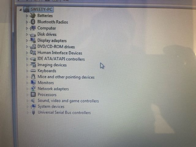

Thank you for your response. I treid to follow above link but got stuck at stage Start>type device manager>open>Ports (COM &LPT). I am not able to see any option called Ports and hence not able to establish communication between laptop and switch. I used LAN cable to do so. Please guide.

3:If after installing the driver, the cable has still not been recognized, please share a picture of the Switch wire to the computer with the console cable and the COM importation displayed in the computer.
Yarenis Hernández.
After performing Reset device still keeps on BLINKING with ORANGE color. I installed the driver too but still don't see Ports option. Attaching screenshots as requested.
