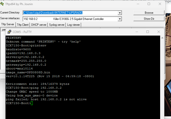

I'm following the guide posted in another post but I am getting trying to do PING but it is saying host is not alive.
printenv
baudrate=9600
ipaddr=192.168.0.3
serverip=192.168.0.2
netmask=255.255.255.0
gatewayip=192.168.0.2
uboot=mnz10114
image_name=SPR08080d.bin
ver=10.1.14T225 (Nov 15 2018 - 04:59:18 -0800)
Environment size: 185/16379 bytes
ICX7150-Boot>ping 192.168.0.2
Change GMAC speed to 1000MB
Using bcm_xgs_gmac-0 device
ping failed; host 192.168.0.2 is not alive

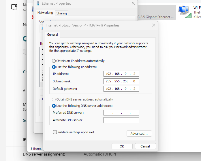

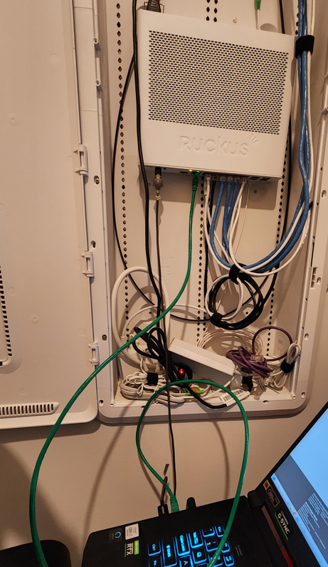

eduardsiquioco
Attaching here all photos of setup of IP and connections to the switch
Screenshot 2023-04-30 181952.pngScreenshot 2023-04-30 182705.pngScreenshot 2023-04-30 182737.png
Hi @eduardsiquioco
Greetings of the day,

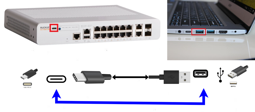

For detailed understanding of the issue, please provide an image/photo where you are trying to connect via console / Ethernet  from ICX 7150 - C12 P (USB type C to USB ) to PC. ( Physical setup ) like the following example :
Before uploading the photos please login to the RUCKUS account and you can upload the image.
Reposted with more pics below
