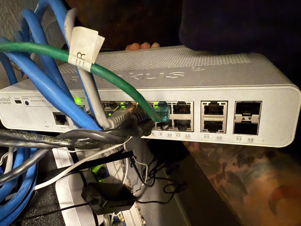

Thank you for your response and for sharing the information.
Based on the picture you provided, the RUCKUS ICX-7150-C12P Switch lights appear to be in a normal state.
Please try disconnecting the Access Point cable from the RUCKUS ICX-7150-C12P Switch and reconnect it to any other available 1 in-12 ports on the switch. Then, check if the PoE functionality resumes. (Refer to the screenshot below.)

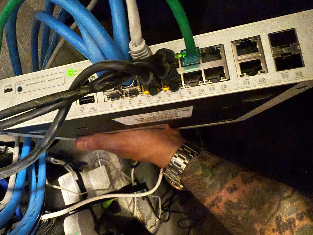

Thank you for your response and for providing the information.
Could you please share a clear, full picture of the Switch showing the PWR, SYST, and other LED indicators? (Please refer to the screenshots below for reference.)
10-30-2025 02:49 PM
Pictures from the top side and bottom so you can see the lights.
If the issue persists, it’s likely that the PoE ports are in a disabled state and need to be re-enabled by following troubleshooting steps. You can refer to the RUCKUS Lennar Knowledge Base self-help article below for detailed guidance:
Please let me know how it goes.
