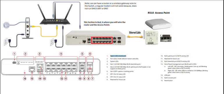

Hi @mollusk82
Basically this would be like the terminology
SPR means Routing capabilities / SPS means Switching capabilities
Correct you should be running (SPS) instead of (SPR) since you already have a router from your ISP and it does all the work at your home (routing/DCHP,NAT etc), you'll need to configure your network and the Switch to use SPR ( Code ) to match the router's configuration.
So it is easier for switches to run SPS as it already does all its work correctly without you having to configure.
Add a common setup for home users.
