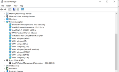

HI @nanners02
Please send us a panoramic picture while you are connected with the computer to the Switch using the console port, also the device manager information, because that error just confirm you are using the incorrect COM number, also take in consideration that you may need to download the USB drivers which are in the same guide.

I downloaded the driver you mention above. It was successfully installed. As for the usb-c port, there is only one on the switch. It is plugged into the port labeled 1 in the picture supplied in the guide.
