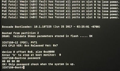

nickdu

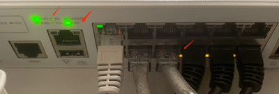

The Switch is working, but some lights color aren't green and my AP devices still no power.
I stuck here, after boot switch, can't reset password:
