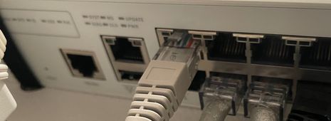

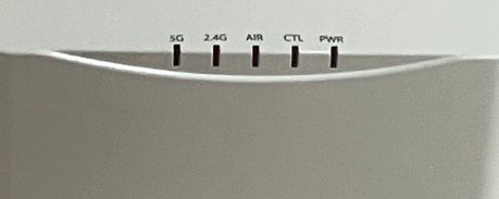

Thank you for your reply, I checked my devices and took pictures :
RUCKUS LED lights: reference the document link you sent me. Lights from 1 to 19 are all off.
R510 LED lights: 5 lights are all off.
ICX-7150 had no power light on. I tried to reset ICX-7150 power, but the lights flashed once and all off.
