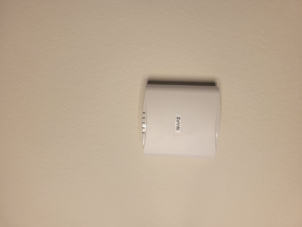

I lost power briefly and all my WAPs have stopped working, they don't have any power. I have searched for different solutions on this forum but have not had any success so far. Please help
34 REPLIES 34

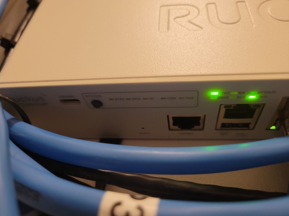

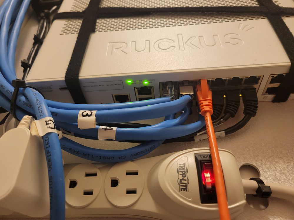

1. Yes, It was working before. There was a power outage before the issue
2. The green lights are on. Find picture attached
3. Yes, ISP is stable and it is working.
4. The are 4 Access Points and none of them has lights. Attached picture20230703_121711.jpg20230703_122024.jpg20230703_123434.jpg

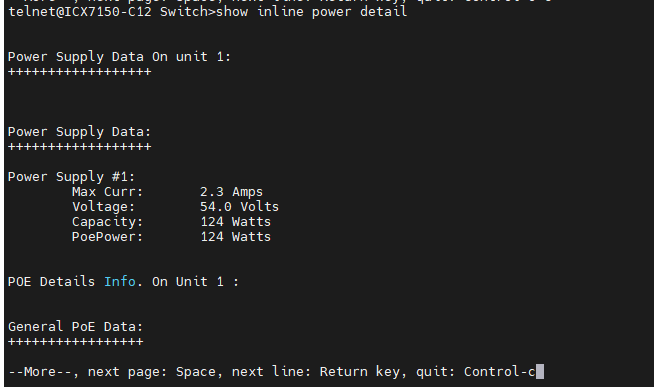

Now, we need to check the Switch port information from the CLI access. To check the same, please follow the below steps and help us with the output of the CLI commands mentioned in this post below.
1. To check this issue, we must identify the ‘current’ IP address assigned by your local router to the Switch ICX-7150-C12P
ICX7150-C12 Router> OR
ICX7150-C12 Switch>
Note: Hit Enter to accept each command.

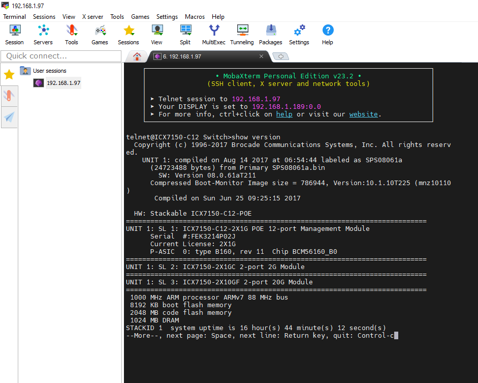

show version

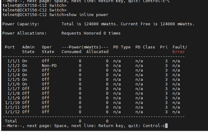

show inline power
show inline power detail
Here you goInline Power DetailInline Power DetailInline PowerInline PowerVersionVersion

As I can see from the information you shared, the PoE is in the disabled state on some of the ports of the Switch (Please refer to the below screenshot). By which the Access Points are unable to get the power.

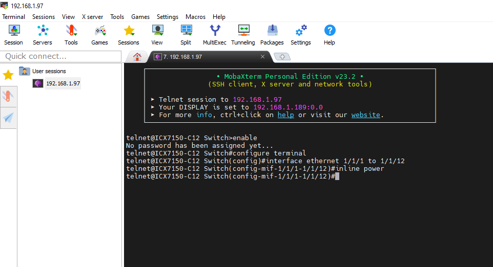

To enable the PoE on the Switch, please perform the below commands from the CLI:
Switch>enable
Switch#configure terminal
Switch(config-mif-1/1/1-1/1/12)#inline power
Also attaching a Screenshot as a reference:
Once you perform the above process all ports should be On, and APs should get the power.
To avoid these issues in the future, I would like to suggest upgrading your Switch to the latest stable version, as your current Switch is on the old version which is SPS08061a. Please let me know once you are done with the above process, to assist you with the upgrading of the Switch.
