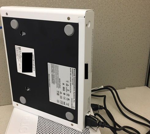

That's a shame they didn't leave the box.  The confusing part is that there is no serial number on the bottom.  If it were me, I would ask the builder for an exchange to provide another ICX7150-C12-PD unit /w Serial because Ruckus provides a limited lifetime warranty on the device.  It doesn't necessarily mean your lifetime but the product's lifetime because eventually everything goes End-Of-Life and End-Of-Manufacturing.
Normally the box comes with a power cord, hte metal retaining clip to hold the cord, and the rubber feet.  I blacked out the serial number sticker on label on the bottom, but that's the label each and every one of these have!

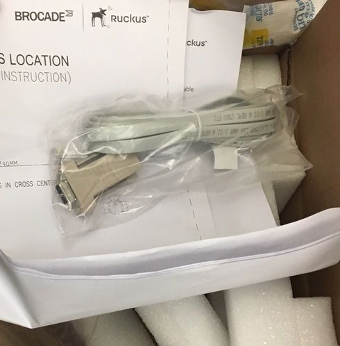

This is the console cable that comes in the box they did not leave you:

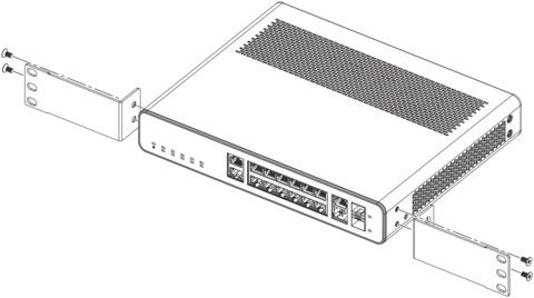

This is NOT included in the box, but if you want to mount it in a Telco rack, it is worth it!  You can also use the the same rack kit as the ICX6430-C12 or the ICX6450-C12, which is what is shown below.
